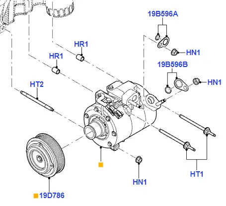

Is this the compressor you are talking about?
Peter
Thanks to both Petes!
The part I needed is *just* the bearing inside 19D786, not the whole compressor(entire picture) or even all of 19D786, which includes the pulley, bearing, coil(aka "stater") as well as the shims needed to align the new pulley with the rest of the belt drive(water pump, alternator, etc.)
