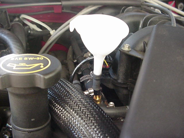

If the PCV valve is anything like mine is go's to the front of the plenum (maybe not on your engine tho) In my mind it will follow the airflow front to back and get all cylinders.
I put a tee inline as I seafoam every couple mos.
called seafoam and was told thats the best insertion point, many people use the booster line, just do's not make sense to me

I used a hair dye bottle when i used the liquid in the TB. I attached a long piece of plastic tubing to the bottle nozzle and fed it through temp sensor port in the tube towards the throttle body - you'll need to work the throttle to get it to suck it up.
A third of the bottle (about 5oz?) into the intake should not hydrolock your engine, just follow the directions.
Another user here disconnected the intake tube from the MAF, and bent it upwards (keeping his hand or a piece of cardboard on the end to produce "vacuum" in the tube) then he poured the seafoam into the oil cooler port in the intake tube.
You really need 3-4 hands to do the TB method.
