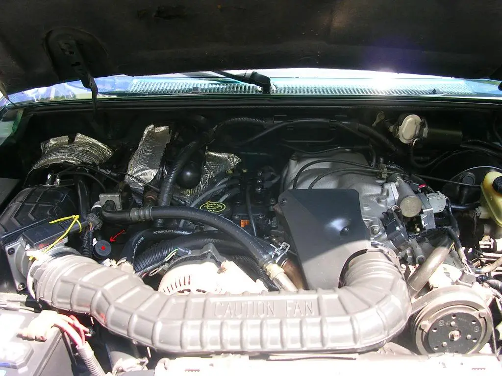

do what scrivyscriv said and bo buy one of those prestone flush adapter kits and flush the system .when i installed mine it's on the heater hose (the one that runs right next to the air box ...best location imho...has enough angle for connecting the water hose and is not next to the firewall and other electronics).
the arrow is where i installed mine .

Wow, is that a clean engine bay! Definitley obvious you don't live in snow country!
BTW, I see you have embraced the same technology as I did for the MAF electrical connector. :)

:p: you like that !? funny i found out why it would not stay connected ( it would click like it was on there but really it was'nt) i was cleaning the iac and the maf and noticed that the old weather boot from the old maf was still on the wire harness ( i thought it was suppose to be there but after looking at the new maf it already had one ......big duh ;) ! now no more tie wraps !!! lol
