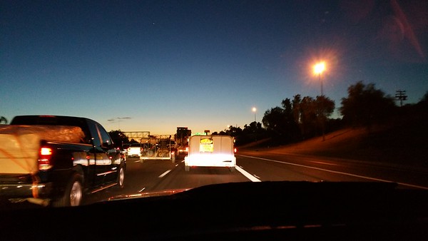

So here are mine in traffic against a flat trailer, pretty flat with the OEM units and HID conversion (taken this AM).
