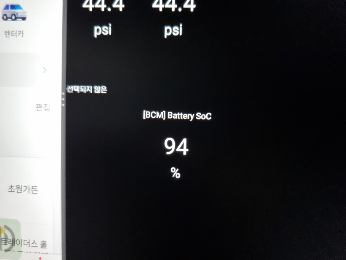

Here's the latest update.
I no longer need to know the PID value.
I sent several emails from the developer of the 'Car Scanner' app and received a reply.
The developer sent me a short and simple reply.
'Hello. No problem, I'll copy soc and Tpms from Bronco to Ford +CAN.'

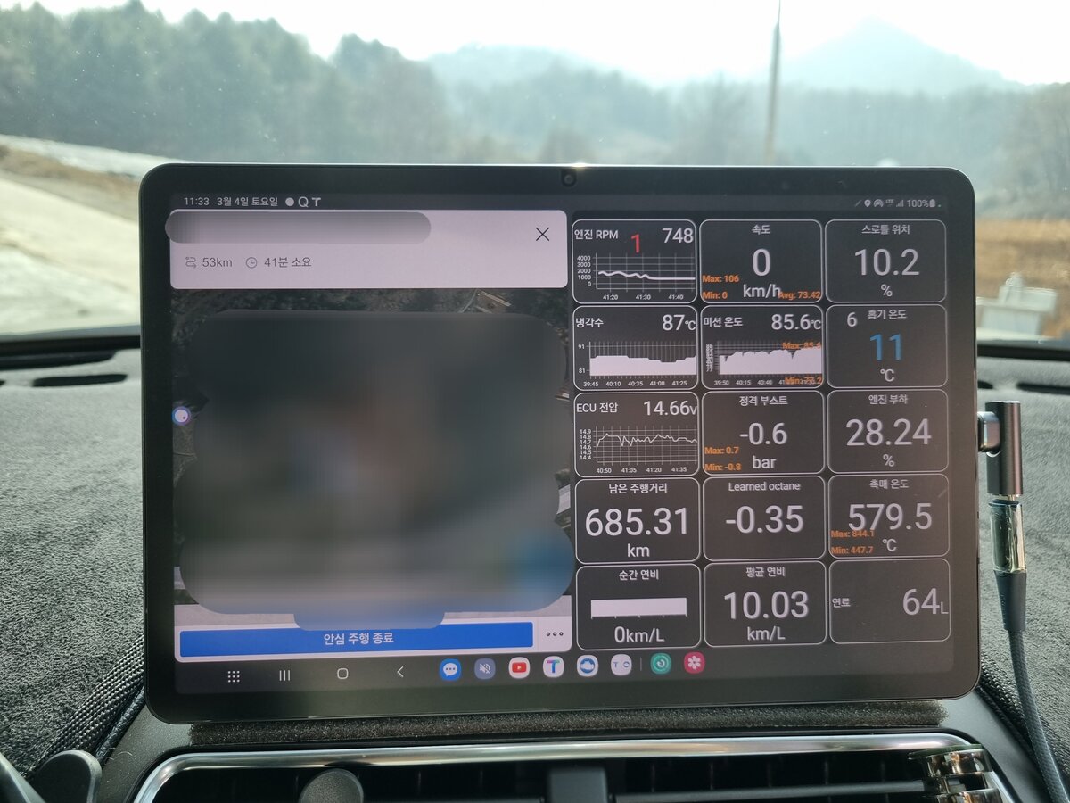

Now, I can additionally monitor the battery temperature and TPMS value, including the SOC value, in the app I use.
In the vehicle, it will notify me with a warning when an abnormality occurs in the SOC and TPMS values, but if I can see the numbers before the warning appears in the car and notice it in advance, it will be very helpful to me in that I can avoid the worst situation.
Thank you to everyone who has responded to me in the meantime.
