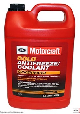

Does one truly need "Motorcraft Premium Gold" coolant. Or can you use regular old 50/50 ?
If one must use the "Gold", I presume the below will work?

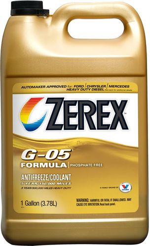

I also read that this is a cheaper option -- is it also ok -- Zerex G05, at only $12 per gallon, less than half the price:
Amazon product ASIN B0033QQ4VW
2004 Mercury Mountaineer, 4.0liter, v6, "awd".
You can use zerex g05 instead of the motorcraft gold no problem.make sure the system is fully flushed and no any dirt or old busted coolant remained.dont mix between fresh and dirty coolant.
