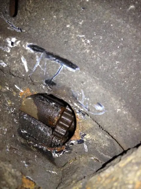

I recently had to adjust mine in order to pass inspection.
I jacked the rear up and had it on jack stands so I could remove both wheels. I took the rotors off to inspect the E-Brake shoes and hardware and to also check what direction to turn each star adjuster for proper adjustment and to make sure the adjusters were spinning freely . I have yet to find a rubber grommet to stick in the hole.
I actually adjusted both sides with the wheels off. On the passenger side the star adjuster gets turned up to tighten. On the driver's side the star adjuster gets turned down to tighten.
Here is a shot of the driver's side adjustment window, as outlined by the red arrows. The yellow arrow points to the star adjuster:
Here is a close-up of the driver's side adjustment window:
Hope this helps out. ;):thumbsup:

I pulled on e drivers side wheel off , and was unsure where to start, you said pull off the rotor/ caliper to check the e-brake shoes. If the shoes look ok, then start the adjustment(star wheel) as needed.
Did yo u struggle to do this,how long did it take . Also did the e-brake shoes appear ok??
thanks for your help!!!
Adjust the star with the rotor off. Making sure the parking brake assembly is centered. Then put the rotor on. If the rotor slides on easy, take it off and adjust the shoes again. Once you get to a point where you have to force the rotor on, back the star adjuster off a bit, so no contact. You should be good to go. There shouldn't be much room between the shoes and the rotor. The shoe assembly can slide vertically in opposite directions, just enough to make the rotor feel tight when it isn't.
