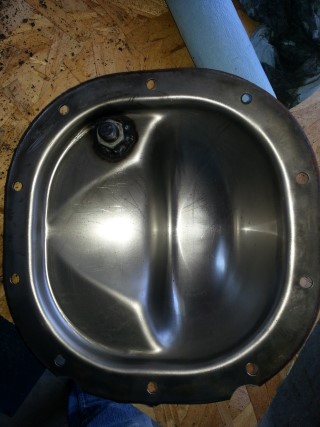

I drained the fluid from the rear diff on my 99 Explorer (4.0 SOHC).
On doing this I made a mistake I haven't repeated since...well about 1975...that is to make sure I could fill it before draining it...I never even looked for the fill hole!!
I removed the diff cover and drained and suctioned the 16 year old fluid out (yup...it was original) at 300000 km I thought it was time to change it
When I was done I looked all over for the fill hole and couldn't find one...I was....miffed....
So..... I drilled a 13/16 inch hole in the diff cover at the one o'clock position as viewed from behind (I made sure there would be no interference) and welded a 3/4 inch nut to the inside and then used a 3/4 bolt and copper washer to seal the hole...tada...
That is what Ford should have done.
ps; my welding aint pretty but it works..
