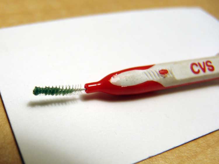

Forgot the most important fix for this issue! Here's $20.00 well spent: Caig DeoxIT® D-Series
Brush that on the connector's male and female parts. Then, use a tiny brush to clean out the female connector. You can find these in the drug store dental isle:
Then, silicone or glue the connector in place. That should be the end of that problem!
Oh yeah, I always forget about that stuff when I put thing back together! Thanks for the reminder.
