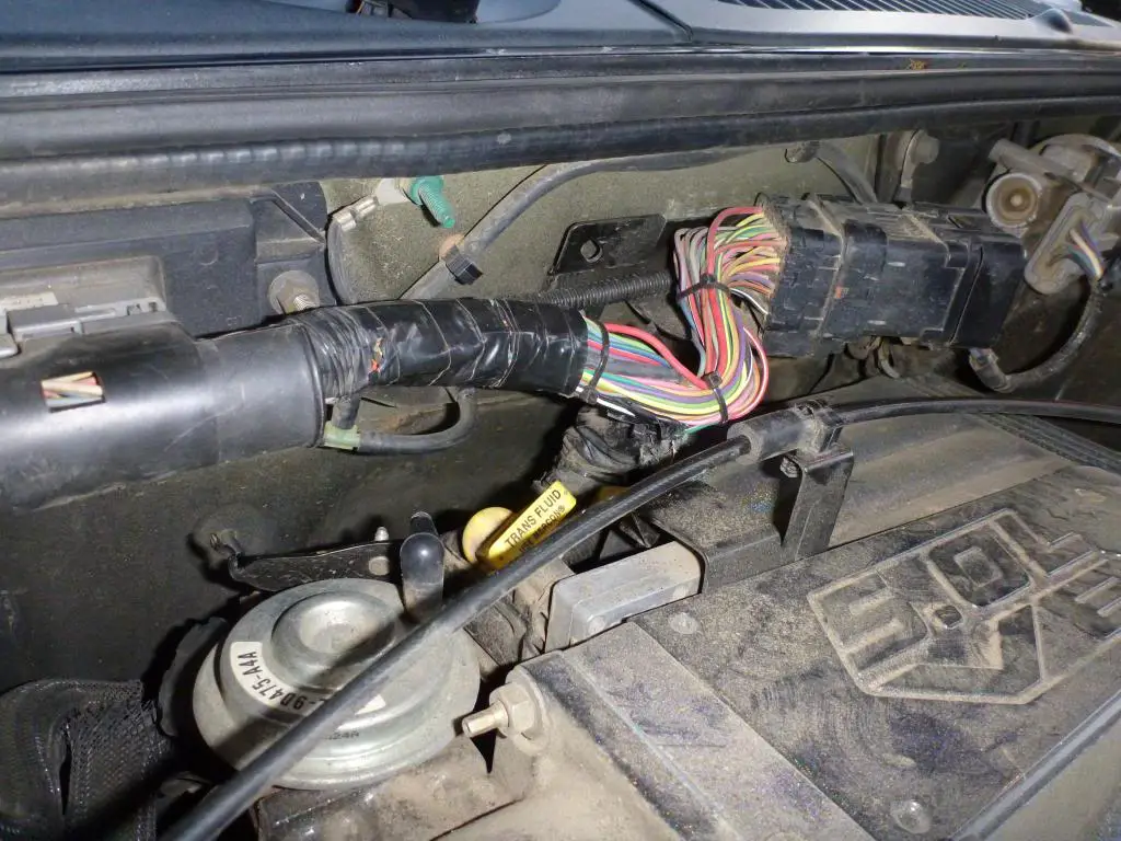

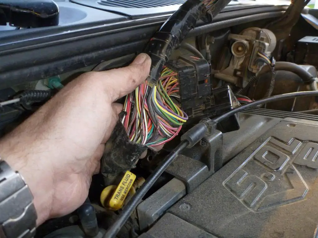

So given what I have observed I am thinking that when the motor is torqued it a particular direction (I think lifting the driver’s side) that some wiring somewhere is shorting or opening which is causing the motor to stall. I will have to put a video camera on it to see, and measure the distances moved to stall in 2wd and 4low.
I have had the Monsterneer on 3 trips since replacing the 4406 I blew up. The first trip was to KOH and I don’t think I ever needed to give it any power in reverse on that trip. I have been driving it quite a bit to and from work, but never noticed this problem in everyday driving. I guess it is possible that some of the wiring running thru the area could have been damaged. I will look in to that.
