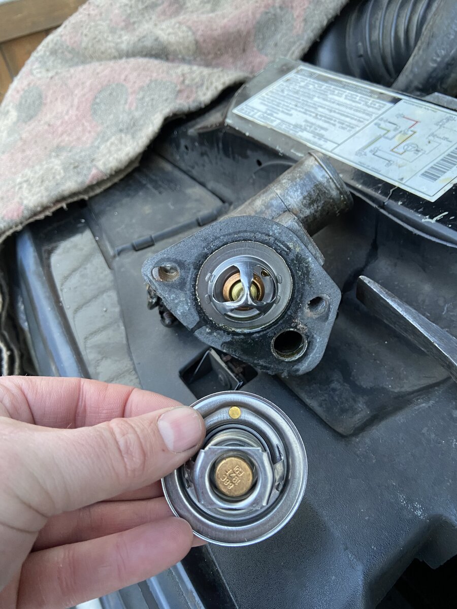

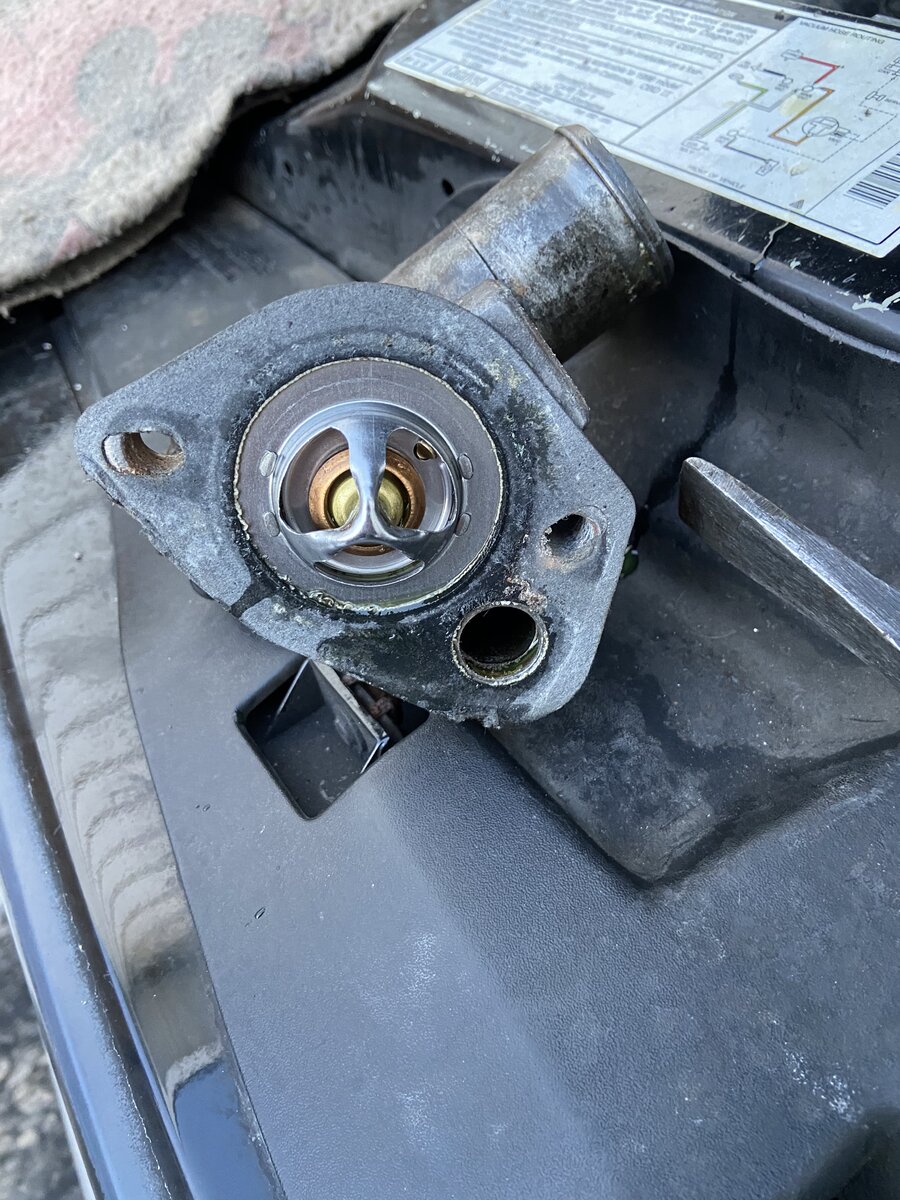

Ok thanks a lot guys I was using a temp gun to get all the readings. Fan clutch brand new. I just grabbed a new t state today I ll let you guys know. I did remove the fan and it took along time but it did get up to 195 so I think abad t stat
Well guys I put it in backwards lol but the funny thing is how come it never overheated ?
