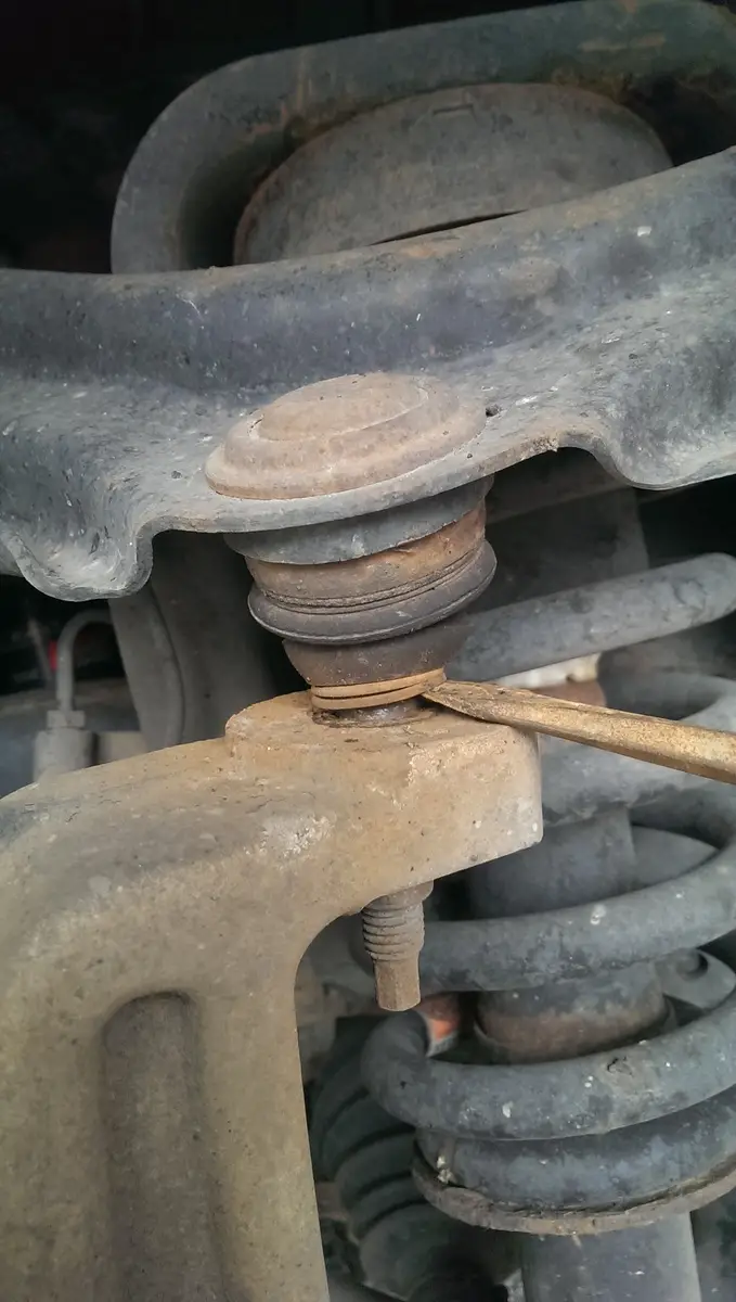

Would this be excessive wear?

No. Your pry device is simply raising the rubber boot upwards on the joint's stud.
The object is to determine if there is clearance (play) within the ball & socket joint. imp
I would replace the ball joints on both sides if it is giving you problems. It's wear and tear.
