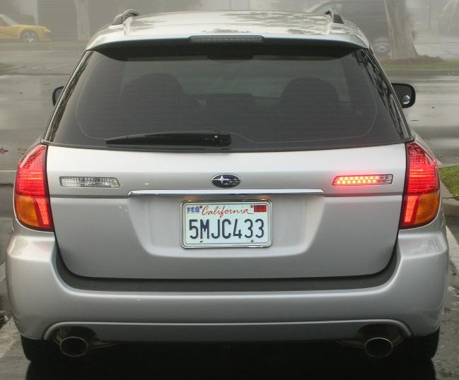

Just for info, some European vehicles have a single rear reverse light & the other side would be a fog light. So, in theory, you could use a red bulb on the left reverse light & wire it to the fog light switch. Not sure if the law requires the lens to also be red or not.
