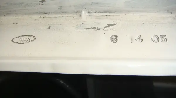

Build date is usually on the door sticker or stamped on the drivers side hood frame.
