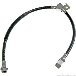

I think this is the part that you want. It is the rear left hand hose

Yes, that looks like it, with another hose also connecting in. My local autoparts store has said they can make up the hoses if I take the parts in. Do you know if all hoses disconnect from the block?
Thanks
AutoZone lists this part for $19.99. Why make it? I DO NOT believe the rubber hoses disconnect from the block. They usually don't, all one piece.
Brakeware/Brake Hose - Rear Part Number: 78330
Warranty: 1 YR
Notes: May require hose lock replacement, part number H1457A
edit: RockAuto shows 4 different manufacturers $14-$19
That is how it comes. The cross axle metal pipe connects into the central block. I got mine via rockauto. If you use express delivery you can get very quickly. (ordered Friday night and was delivered Monday morning).
Cheers guys, I will get on and order one from Rockauto
