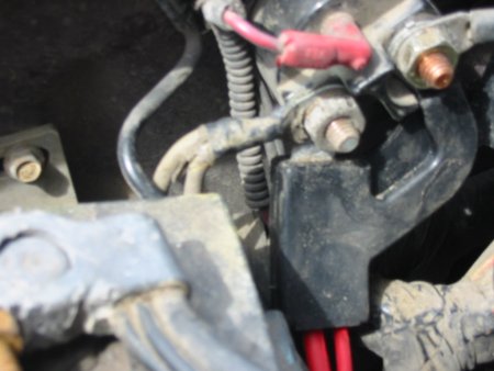

The click you hear is from the Starter relay mounted on the passenger finder next to the battery (pic below). How old is your starter? I could be any number of simple things, but I would tap the starter motor (located on the driver's side).. Tapping an old motor can help free it up and get it going again..
