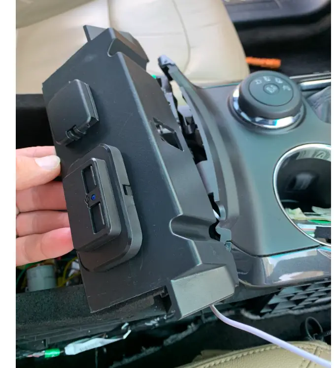

Here is the socket
amazon 4.8

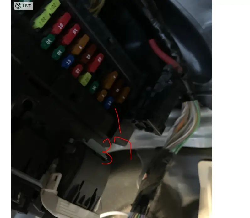

You need MICRO2 Fuse ADD A CIRCUIT
Amazon product ASIN B07SR71LPP

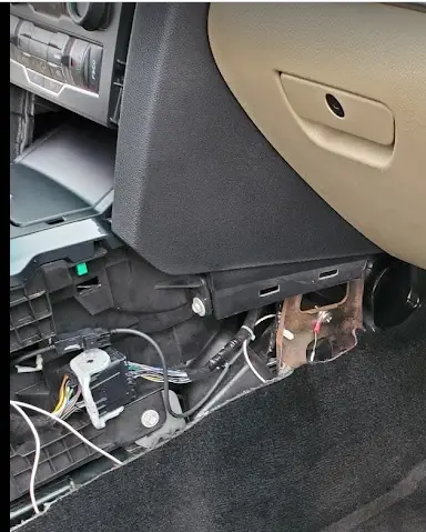

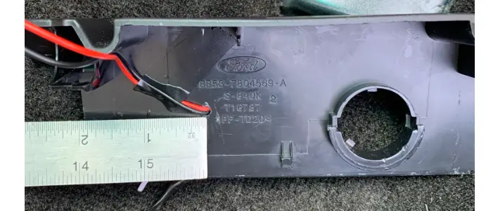

I used a M8 with nut to ground on the bracket below the radio that had an existing hole.
Easier to take the seat out to do the job but I think u can do without.
To take the side console panel start from the backseat pull out and when you get to the front PULL DOWN so you dont break. The last tab near the floor vent is PULL DOWN to get off.
I tested the USB output and its about 2AMPS so not bad.
Looks nice, I like how the usb ports look like they have built in sliding port covers.👍
