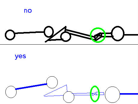

try to level the frotn of the trailer with the rear of your truck, as flat as possible, otehr than that, it soundsl ike you have it figured out... it sounds like you will be towing a lot, so might wnat to invest in an aux tranny filter/ aux cooler....
like this if it makes any sense....
