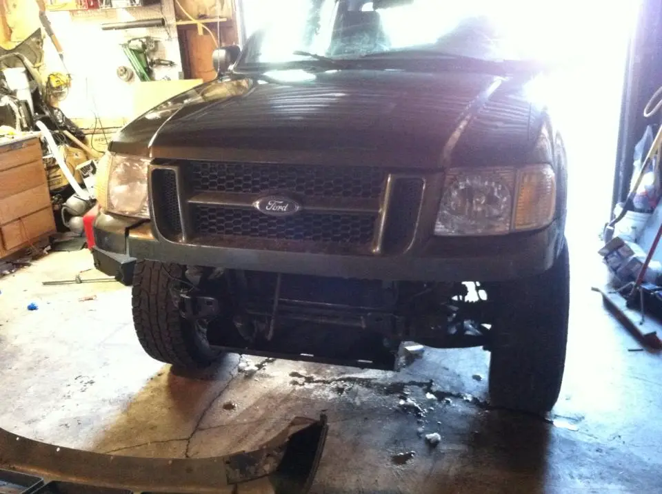

Well, the day before Christmas eve, my truck took on a snow filled ditch and wound up in a tree. Had to dig her out, and then kicked it in 4 wheel drive and drove up out of the ditch. I was amazed at how well she did. But i realized at that point i needed new tires.
When i hit the tree, it busted my front bumper up some more. (it was already cracked in several places from the previous owner.) So at this point i started "trimming"...and ended up with this ;)

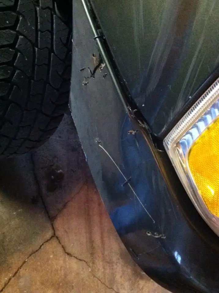

I put a few custom stitches on the truck to hold the bumper together...
