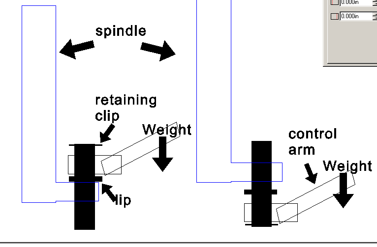

If you fllip the lower balljoint, all the weight is going to go on the little snap ring, which will hold for about 2 seconds.

Actually, it wont. The reataining clip will be on the bottom instead of the top.The way it is now, theres more wieght on the clip than the way i would do it. so technically, the balljoint would push right back trhough. i am still doing some reasearch tho.
Yeah, exactly, the clip is going to be on the bottom. The weight of the truck pushes all the weight downward. In it's original position the balljoint housing has a lip which is where the weight is put on. The clip is only there to prevent the balljoint from "slipping" out of the hole, no weight is put on it.

ok, thanks for clarifying, i thought you were talking about the retaining clip not the lip.
Yeah, I'm saying if you flip the bj the clip is gonna be supporting the weight.

edit: Pictures to the rescue (I'm bored)
Makes more sense now. What if i use a washer in between? no?
