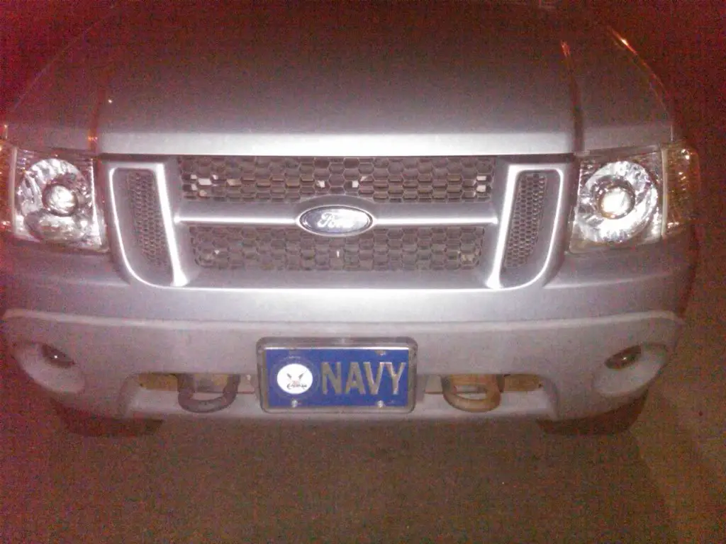

got them seal up,dried, aimed and mounted!! cutoff pics to come when i can find a nice dark wall to project on. anyways, here it is!
i blew a fuse in mine too when i first got my bixenon harness hooked up, and it was the 9007 connector was pinned wrong which caused the fuse to blow. repinned it, replaced the blown fuse (can't remember which one it was but i can find out if you need) and everything works good now!!
ur retro looks great too!!!
thanks! im quite proud of myself.lol. and yep, my harness was 9004, so a repin was a must. i had to rig the projector solenoids myself cause my connector didnt match the harness, easy enough, i just used quick connects and heat shrink tube. i also had to swap out one of the aiming devices because the new one wasnt threaded.
Yeah for some reason HID harnesses that are 9004/9007 always come pre-pinned for 9004 which is annoying lol
I'm curious, did you use the factory Ford headlights for your retro or aftermarket ones??
bought new (oem) housings from ebay for like $40+/-.lol
