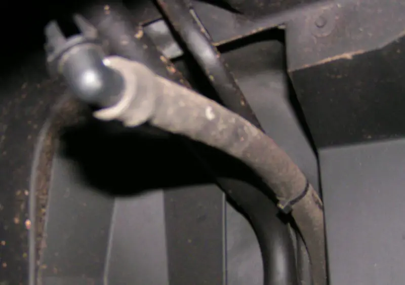

The medium sized hose should be the vent going back up to the metal fuel filler pipe. I don't see why you should hear fuel gurgling when you blow through this hose. I don't own an '05 so IDK if the fuel tank design changed from the '01, but the vent hose should just be for air to escape during filling. Can you tell if the gurgling is from the vent hose (like the resistance you feel when blowing thru a straw into a full glass of milk) or is it just the noise of fuel being pushed up the fill pipe? How full is your tank? It should never be so full that the fuel can block the vent pipe. Besides the hose going to the fuel tank you need to make sure the smaller metal pipe going to the top of the filler neck is clear.
The small hose tube is metal that connects with the filler neck, it goes down so far then there is an actual hose connect to the metal one which looks like it goes to the top of the tank. The medium hose is the one I was able to blow thru, it comes up and attaches to the sidewall of the fender area. That one seemed clogged but after blowing thru it it was free, but I can hear gurgling thru it. My tank is only about 1/2 full

Here is a pic of the medium hose, it has the clip on the end, This is the one I can blow thru from the top and I can hear gurgling thru it.
