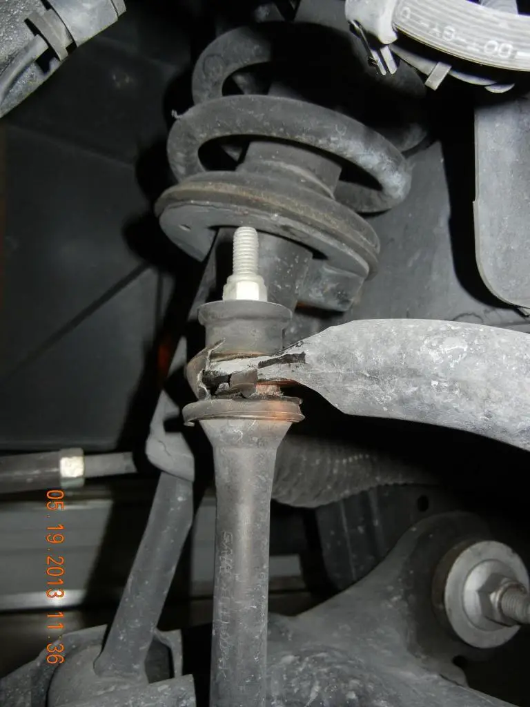

Or at least I hope so. I've had the vibration longer than I've noticed this blown bushing so maybe there's something else going on down there. Will find out this weekend when I plan to replace end links and sway bar bushings.
Anyone do this job on an '06+? Looks fairly easy.

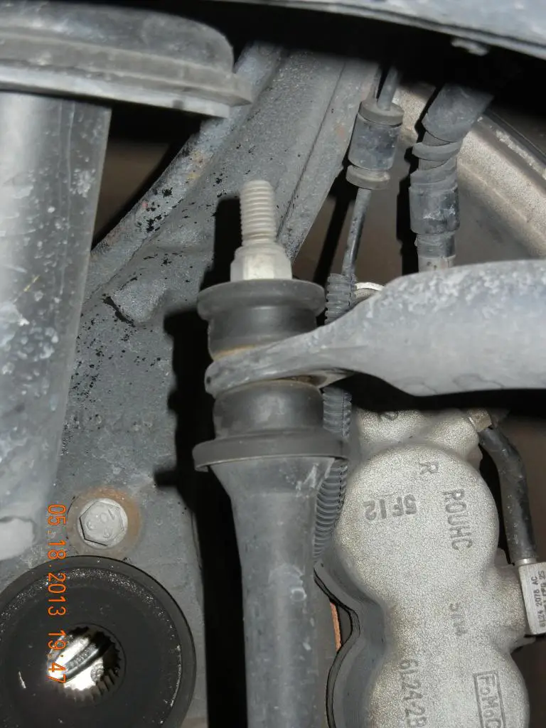

Here's the right side for comparison:
About half an hour for both. Do not need to take the wheels off, but you will need to force them there or turn the wheel a little to "unload" the stabilizer bar.
