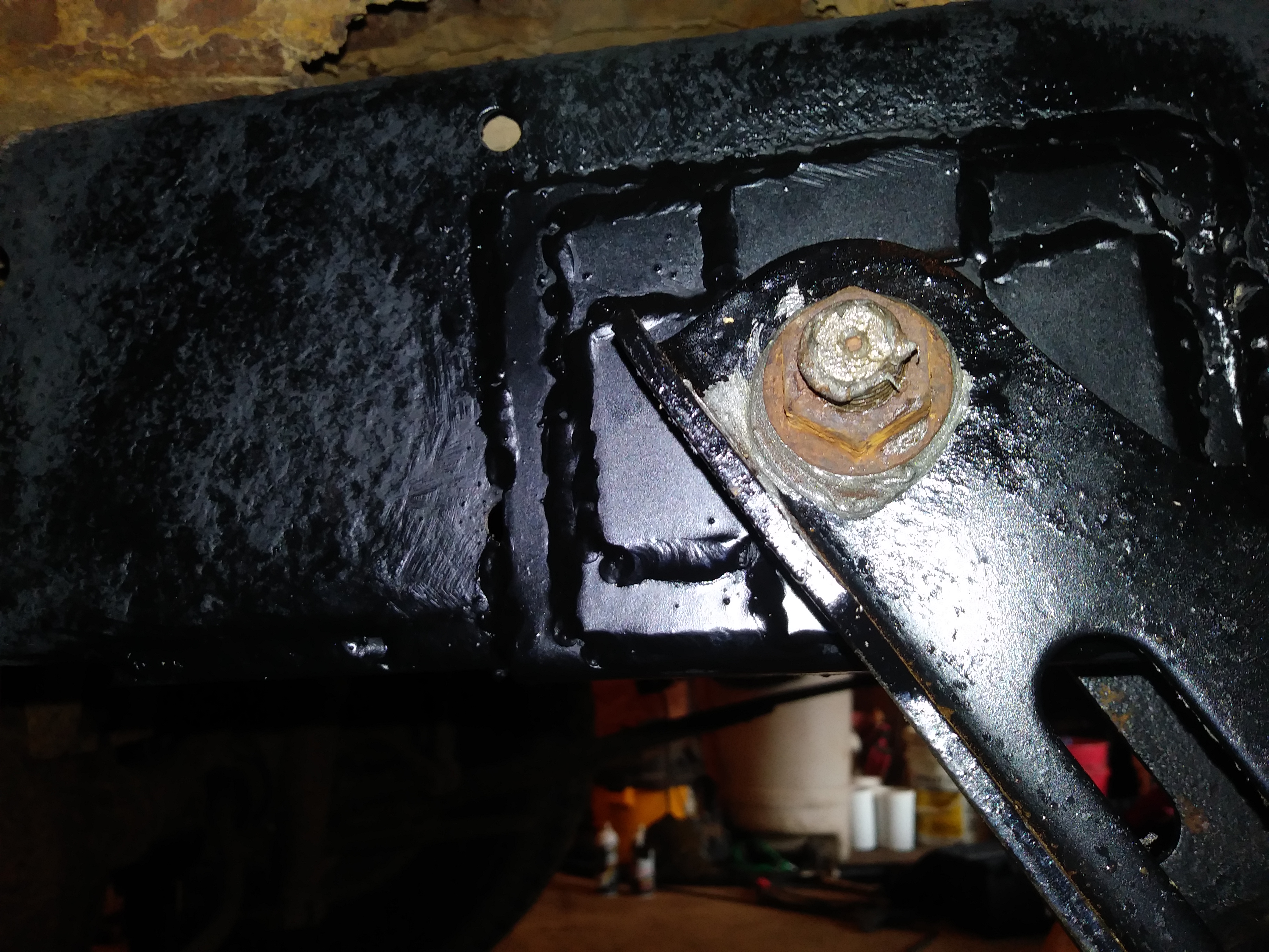

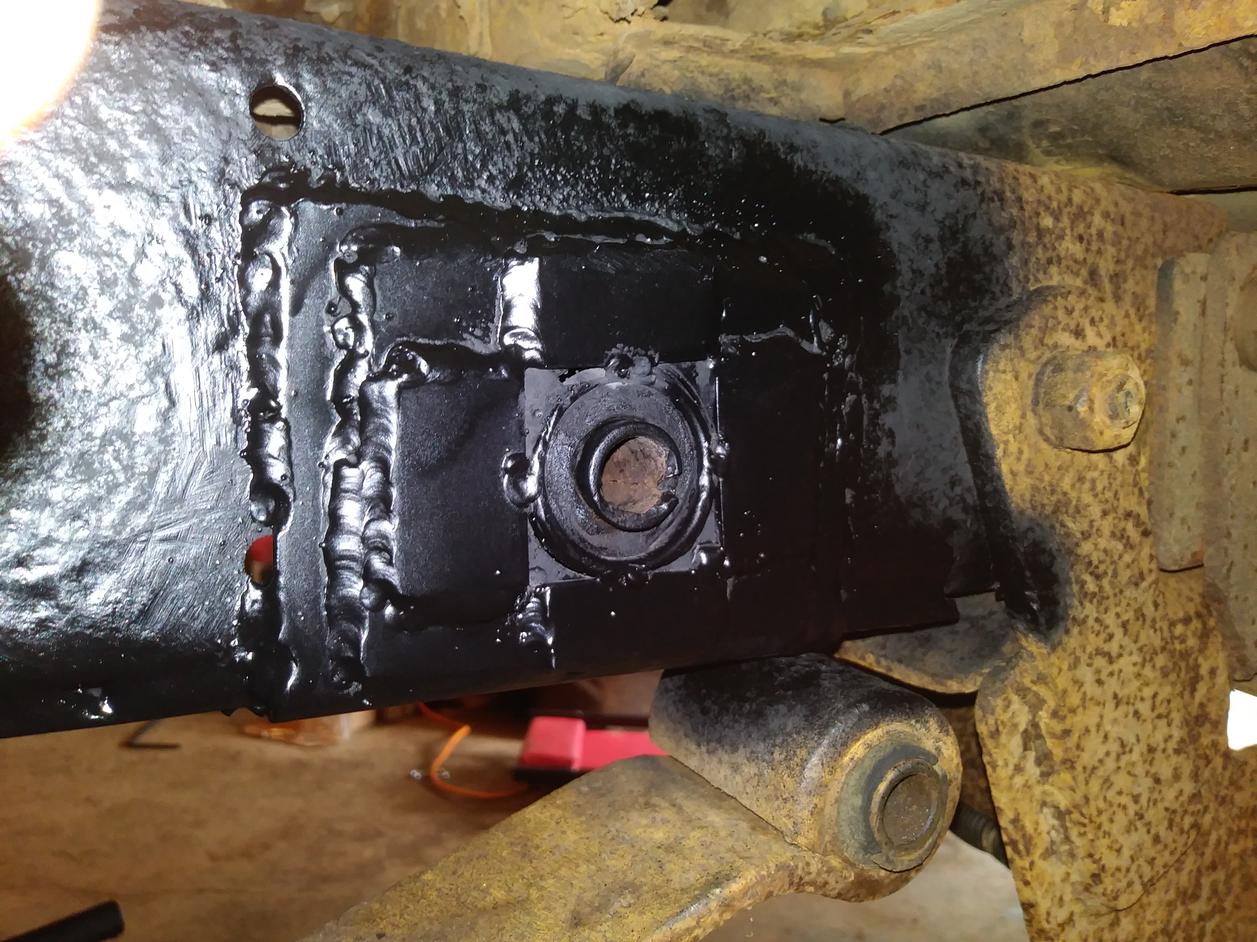

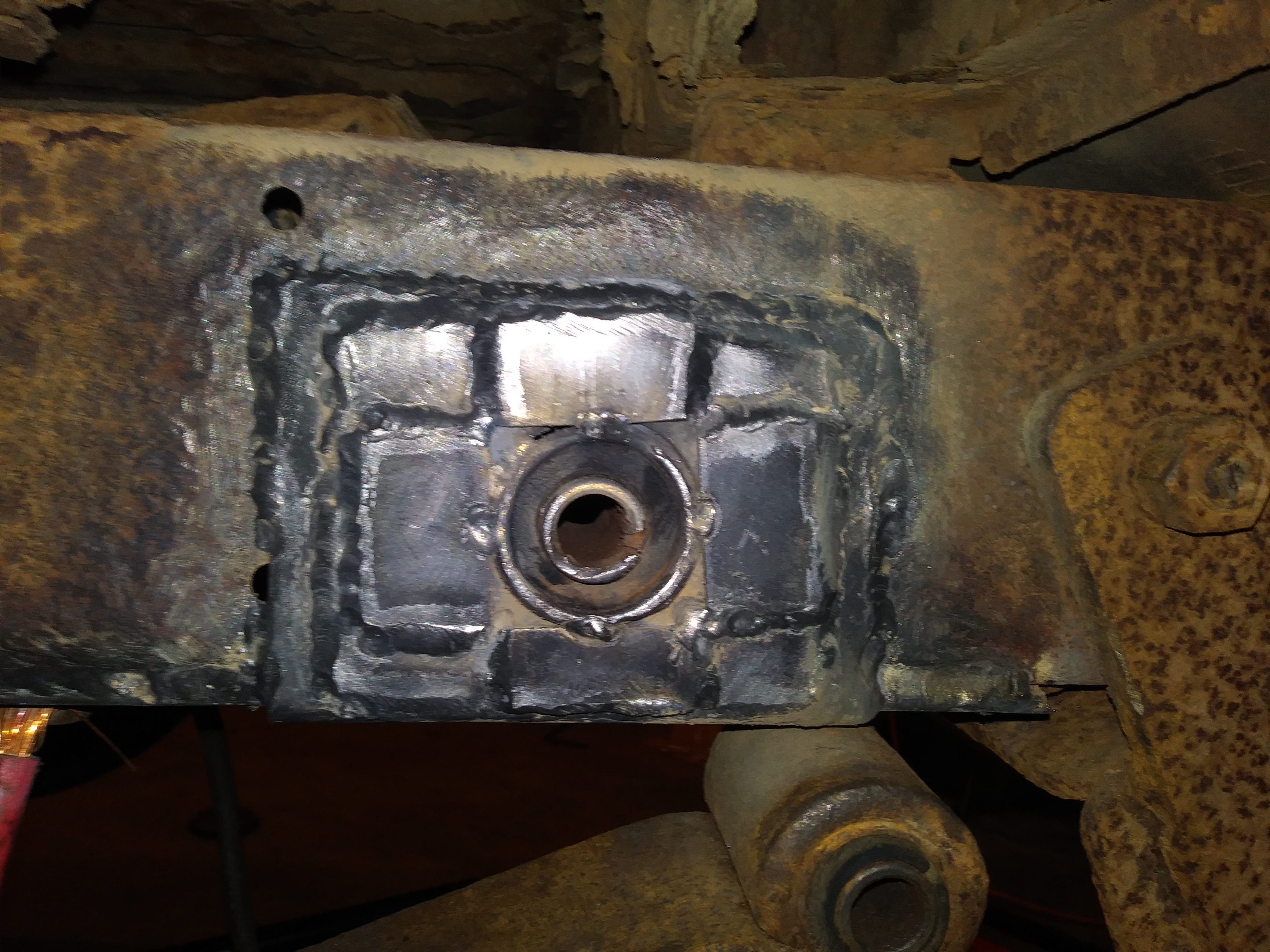

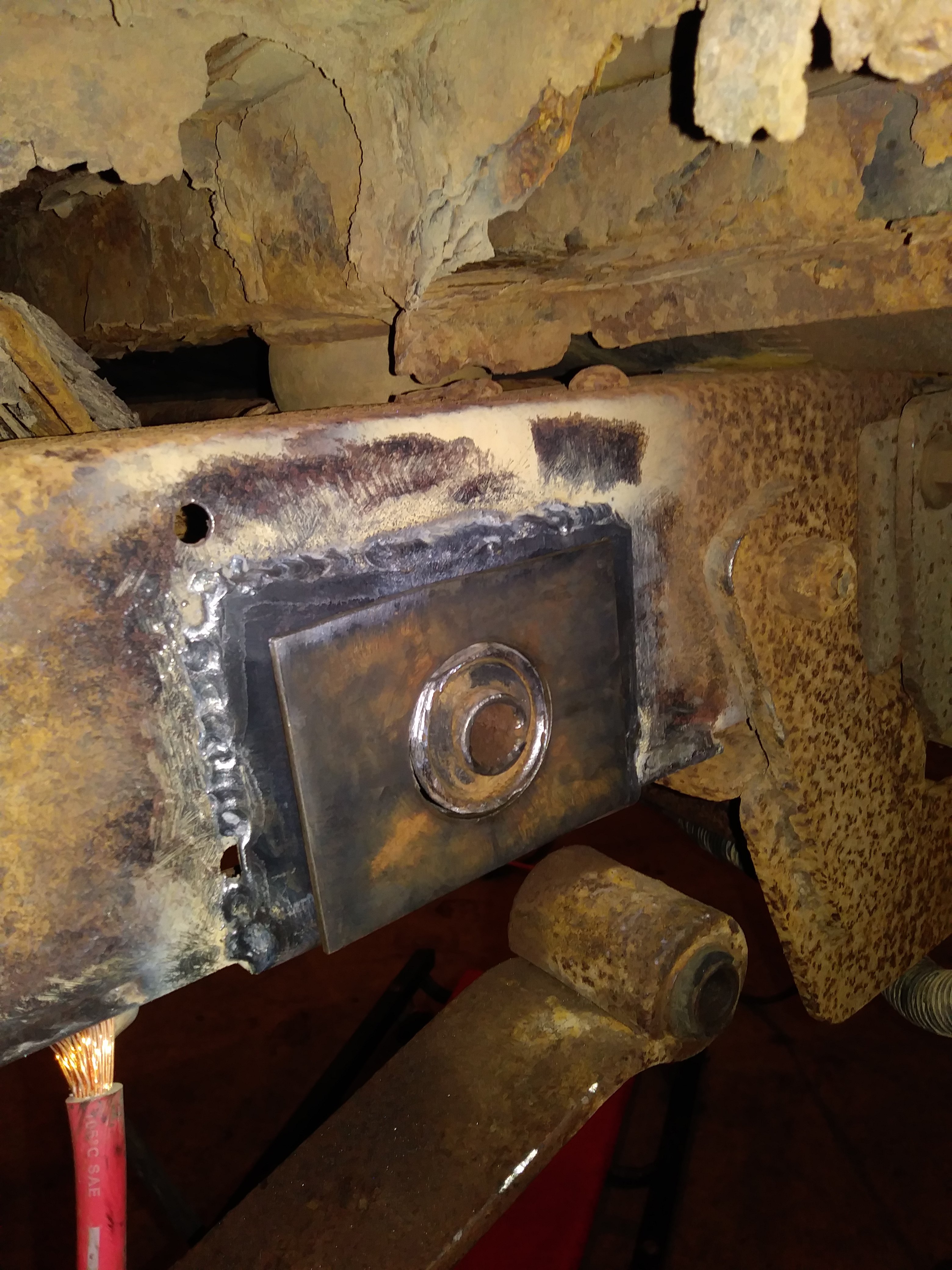

What’s the reason for two separate plates? What holds the second plate on?

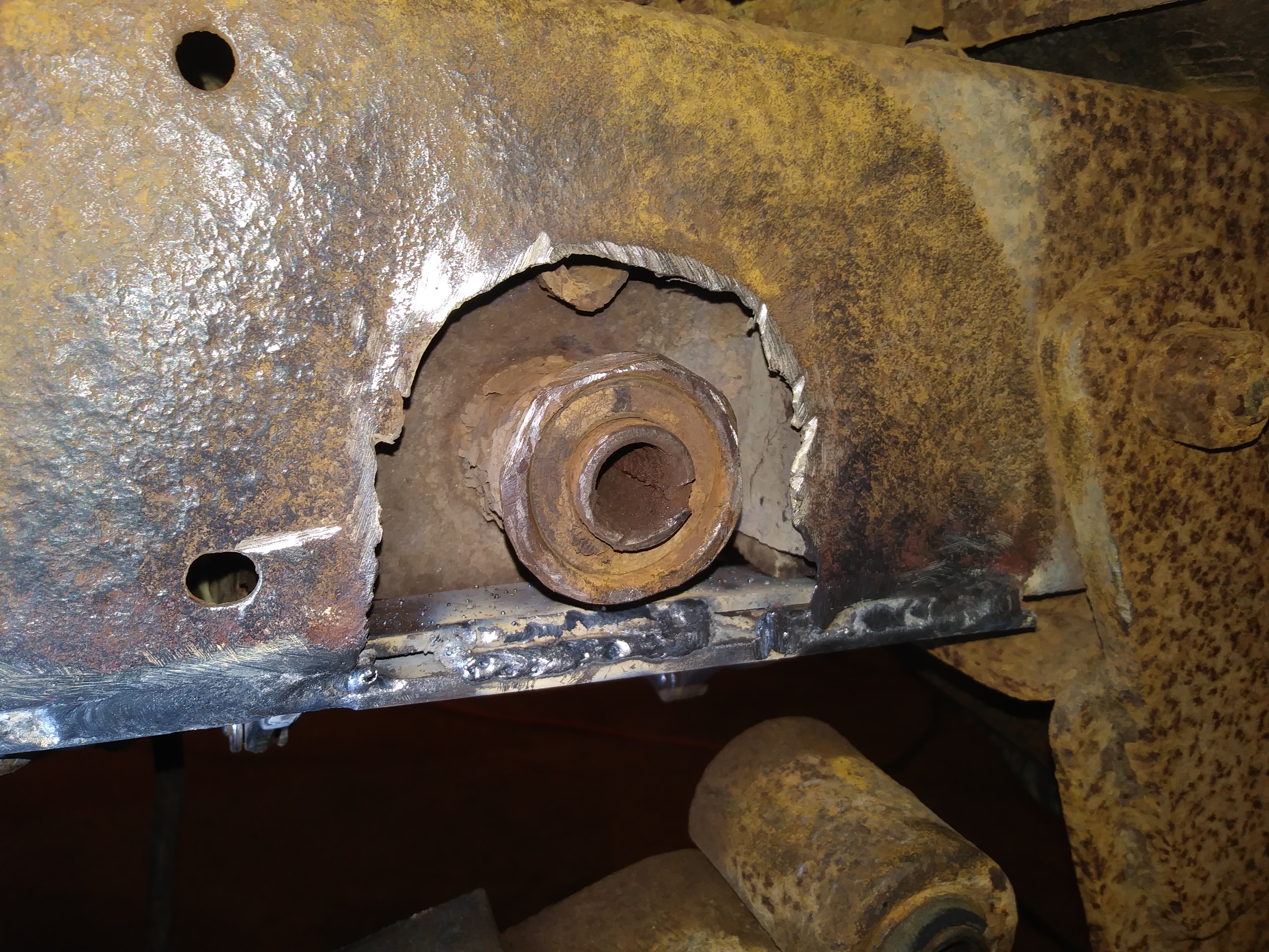

because of the way the frame was raised outwards and i had cut that portion out and put in a flat piece i had to weld on another plate to get it out to the end of the bushing and even then i added those 4 small plates to bring it flush to the edges of the ring.
i will keep an eye on it and check it regularly to see how it holds up
Nice repair!

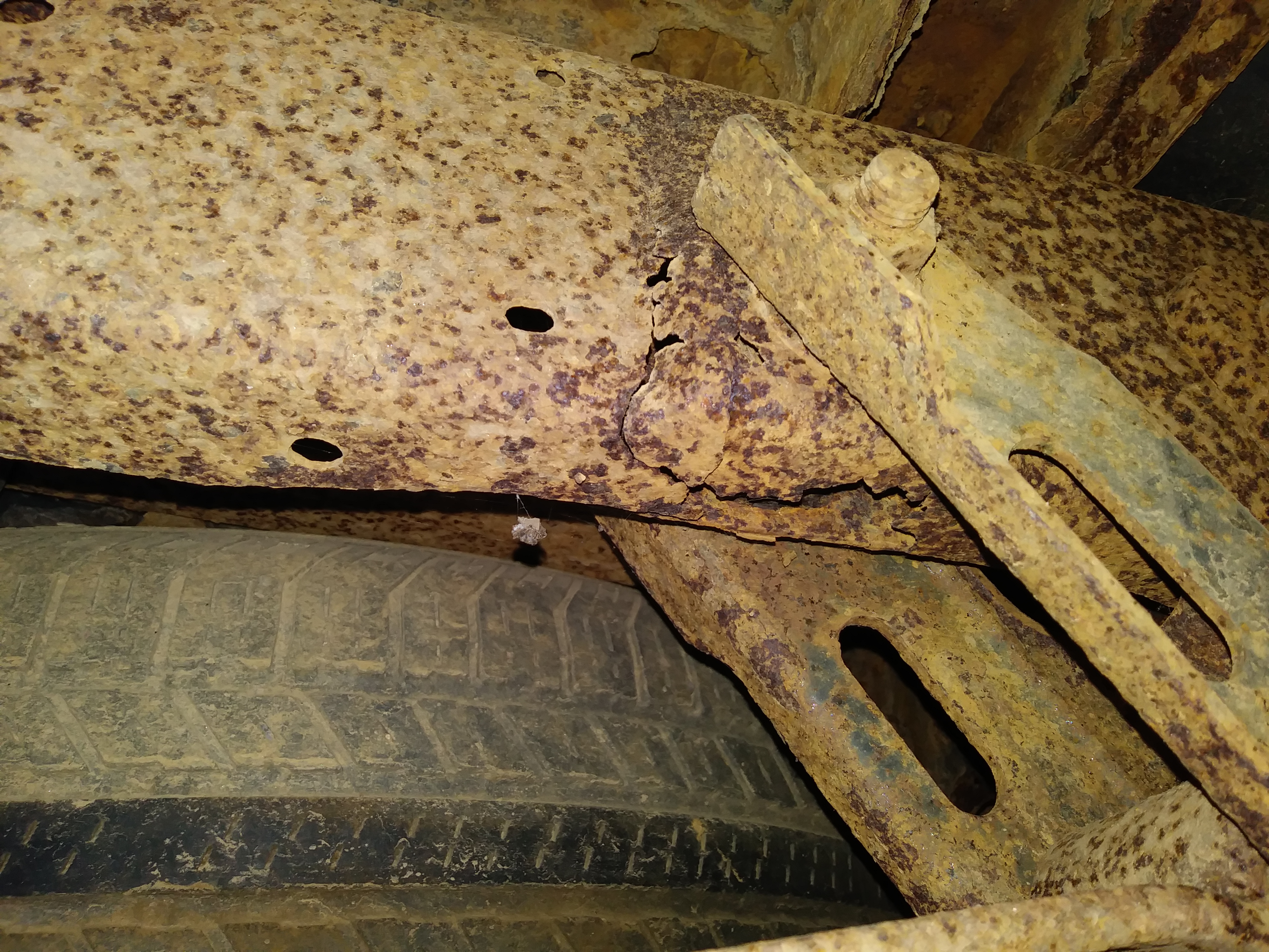

I live in MA and we have similar issues, spring shackle area is a common problem. Around here the bodies/chassis rot before the engine dies lol
