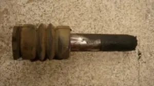

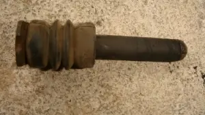

^ Agree. Remove BOTH pins on each caliper and check for corrosion. Avoid getting brake cleaner on rubber parts to prevent swelling. Also important to use specific high temp silicone brake lube on the pins and all caliper hardware. Do not use regular chassis grease or anti seize or they will be guaranteed to bind and stick. Pin pics below caused a sticking caliper and other damage from overheating.
