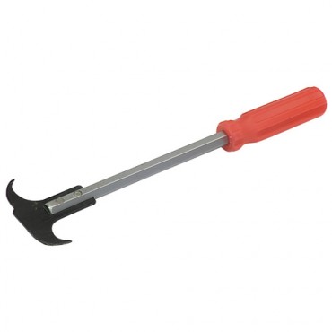

Use a seal puller (see photo below) to remove the seal being careful not to scratch the crankshaft

I have found that by using a common paint can opener, available at just about any hardware store, it is easier to remove the front crankshaft seal. The seal puller designed for the job has too long of a handle and is awkward with the radiator still in place. I have used this method many times and it works well.
