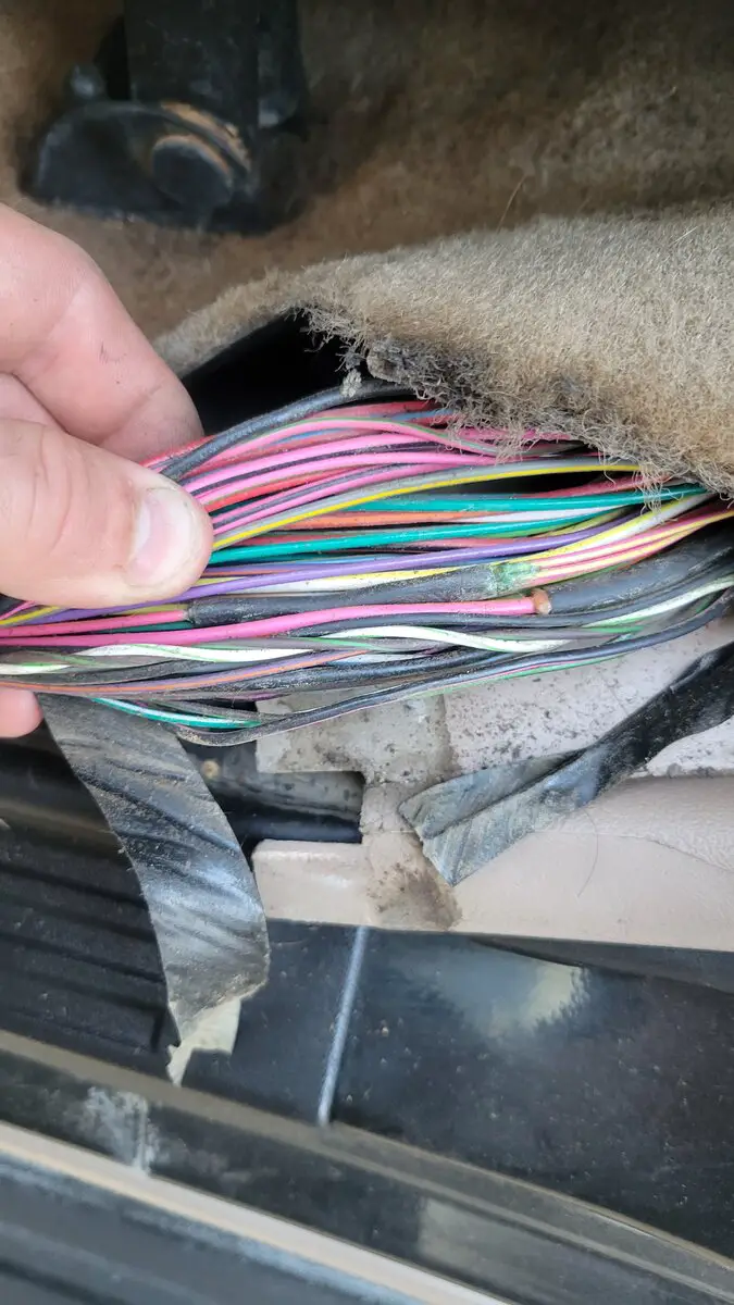

I've seen a bunch of posts for this issue, but non ever were simple and straight to the point. So basically if your explorer is having issues with locking/unlocking (Either front doors only lock or only unlock, but your cargo area switch works both ways.) Look for the wire in the picture (Pink with yellow stripe) and it will usually be this splice. Ive seen it in 3 of my 2nd gens. Fix the splice by removing corroded wires and rejoining them with a couple inches of new wire.
