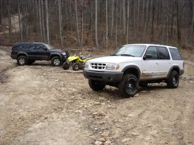

In my efforts to make my Explorer a better off road vehicle, i've started with things it needs the most.....RECOVER POINTS! ;)
Not really bashing it, but I have gotten stuck twice and needed a tug, one from the front and one from the back. I got a set of hooks mounted on the back frame ends. No biggie there, drill and bolt on.
I plan to put a winch on the front, but don't want to do the square-ish metal/tube bumper. The stocker is fine as this is my daily driver. The front mount receiver will serve dual purpose. Currently in my broke $$$$$ state, it'll be my recovery point. Future will be a removable winch mount. Far far future maybe rigging up a receiver for the back to make the winch usable at either end.
My cousin gave me this universal Class III hitch and a wheelin' buddy helped with his plasma cutter and welder. He's the same guy that I plan to turn loose on the front end Dana 30/3-link swap possibly in March(depending on $$$$$).
As for the hard part.....I found some white mesh and decided to make a cosmetic grill to purdy it up. :D:p: With that receiver kit were some thick metal brackets. I'm going to see if my buddy will weld me up some sort of bottom radiator/condenser guard for that area. The brackets are thick and the perfect length, they'll just need a bridge joining them frame to frame. I've had some small dings on the lower fins of the radiator, and I want to resolve this issue ASAP.
(Last outting, no receiver/grill)
