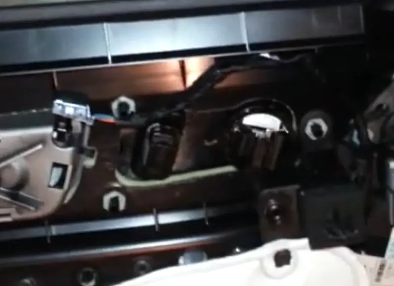

A screen cap taken from https://www.youtube.com/watch?v=vbDfXiIABJU (thanks Paul's Travel Pictures guy!) shows the tweeter is indeed integrated into the front door. Now the question is can I fabricate a mount for new tweeters from plumbers strapping that would keep the new tweeter in the same locale.

indeed. two small self tapping stainless screws, plumbers strapping, and adhesive weather stripping placed around existing opening to serve as a non-rattling gasket of sorts
