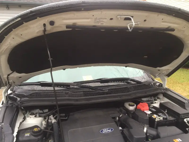

Here is a pic of the hose hanging down after I removed it from the hood (after I disconnected the nozzle from the hood - see above (earlier) posting and enclosed pic for how to remove nozzle).
The red arrow indicates the end of the hose. You will feed this down into the hood (in the opening) to the nozzle area - you will route the hose out through the nozzle hole area and connect the end of the nozzle to the hose. Once the hose and nozzle are connected, you will feed the hose back up into the hole, as the nozzle is snapped back into place. The hose connection to the nozzle is hidden up under the hood.
Hope this helps others in the future!
