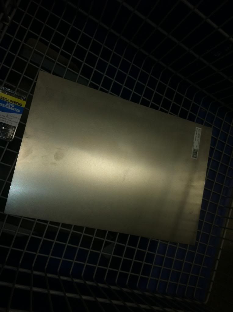

Why would you say its the worst thing to do? I have removed the seats and pulled back the carpet now. I'll try to post the pictures later. But I found a rubber plug and pulled it out. After looking in the hole I can see the top of the fuel pump and sending unit. My plan now is to measure accurately and drill a few 1/4" holes. I will use a drill stop set to 1/8" to prevent from hitting anything on the back side. I have a pair of aviation snips and I will trim an opening. Then I will fabricate a new panel and using sealant make a form in place gasket. Using self tapping screws to reattach.

Here are the pictures so far... <div style="width:480px;text-align:right;"><embed width="480" height="360" src="http://pic2.pbsrc.com/flash/rss_slideshow.swf" flashvars="rssFeed=http%3A%2F%2Ffeed1336.photobucket.com%2Falbums%2Fo658%2FTim_grov3%2Ffeed.rss" type="application/x-shockwave-flash" wmode="transparent" /><a href="javascript:void(0);" target="_blank"><img src="http://pic.photobucket.com/share/icons/embed/btn_geturs.gif" style="border:none;" /></a><a href="http://s1336.beta.photobucket.com/user/Tim_grov3/library/" target="_blank"><img src="http://pic.photobucket.com/share/icons/embed/btn_viewall.gif" style="border:none;" alt="Tim_grov3's album on Photobucket" /></a></div>
<a href="http://s1336.beta.photobucket.com/user/Tim_grov3/library/" target="_blank"><img src="http://i1336.photobucket.com/albums/o658/Tim_grov3/explorerrepair_zpsbac5be2c.jpg" border="0" alt="Photobucket"/></a>
http://i1336.photobucket.com/albums/o658/Tim_grov3/explorerrepairnewpanel_zps847d02cc.jpg
<a href="http://s1336.beta.photobucket.com/user/Tim_grov3/library/" target="_blank"><img src="http://i1336.photobucket.com/albums/o658/Tim_grov3/explorerrepairtemplate_zpsc1366e2d.jpg" border="0" alt="Photobucket"/></a>

It is hard to see many of your pictures, so no comment there.
