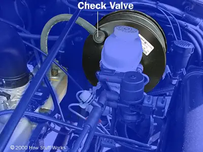

i would venture to say that if there was not fuel in the lines you took off that maybe none got into the brake booster , i don't know exactly what is inside one of them right of the top of my head, but i will search google and a few other places i know and see what i can find for you on the inner workings of a booster , maybe it will be as easy as drill a hole drain it, and put a sheet metal screw in the hole to seal it,, but don't try that till i find out whats in there,, okay,
,,,it appears that there is only a large bladder inside the booster that uses the vacuum to hel[p aplly pressure to the rod that activates the pistons in the master cylinder
there is also a one way valve that only allows air out of the booster

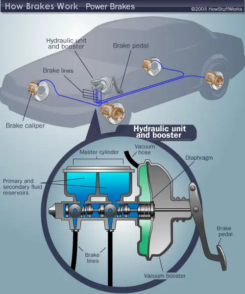

brake system, so, apparently there is nothing inside the outer part of the booster that will get damaged if you drilled a drain hole or air bleed in the front of the booster , and than sealed it back up after the fluid was drawn out of it, , just make sure the hole gets well sealed again, and don't drill the hole real deep or dam,age to the bladder may happen and than it must be replaced,,
i hope this helps ,
