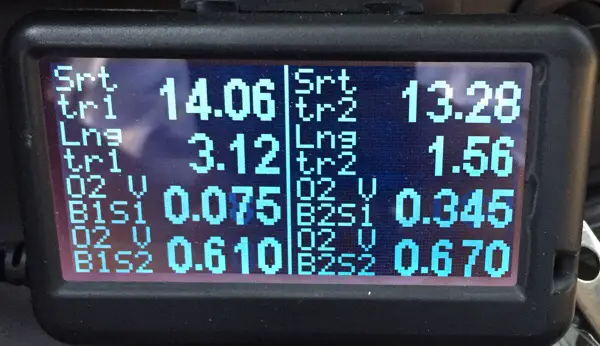

'04 4.6l 167,000. Timing guides and tensioners a were replaced last year, I believe.
So recently my long term fuel trim has been running at +3.91 or so, but also near 0.
The short term has spiked as much as +13 and as low as -4.7.
02 sensors seem to be running at proper voltages.
Fuel trim is more problematic on bank 1. Worse at start up and initial drive. Once I've been driving for a bit (usually freeway) it almost levels out, but not always.
Yesterday, dropping my daughter off at home, the exhaust smelled of rotten eggs, first time and not since.
Idle seems to have a miss, but I checked for a misfire and there was none.
Negative fuel trims.
I guess as a note, got new Autolite Iridiums at time of timing chains but reused coils and boots.
If you read the article, you'd see that there can be a detected misfire, but if it isn't sufficient, it won't set a code. When I looked to see if there were any variances in cylinder to cylinder 'soft' misfire, there was none.
