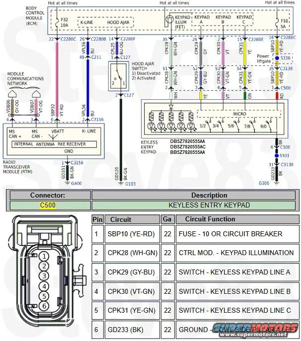

I searched a bit, and couldn't find any info about adding the factory keypad to the driver's door on a vehicle NOT originally equipped. It looks like DB5Z7820, DB5Z7820555AA, DB5Z7820555AC, & BB5Z7820555AA will fit & work for me, and I can either look up the wiring or probably find a JY door harness to cannibalize, since I'm sure mine doesn't have the connector. But what about activating it? Can that be done with ForScan? I've read several ForScan threads, but I don't remember seeing anything about the factory keypad.

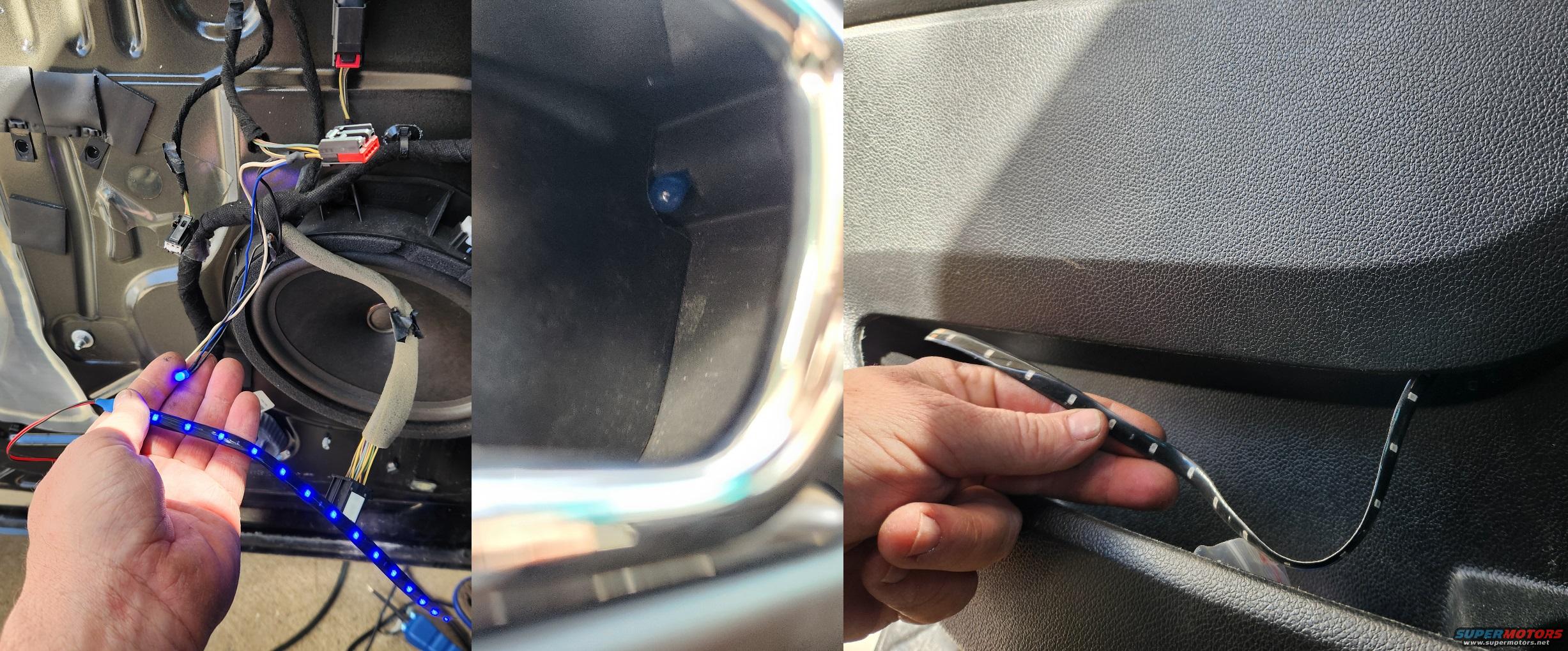

I had mine off for LEDs, and didn't see any unused connectors.
I've done more digging and found that the blue C2280E on my BCM doesn't have the keypad wires.
So I added them from a JY pigtail.
