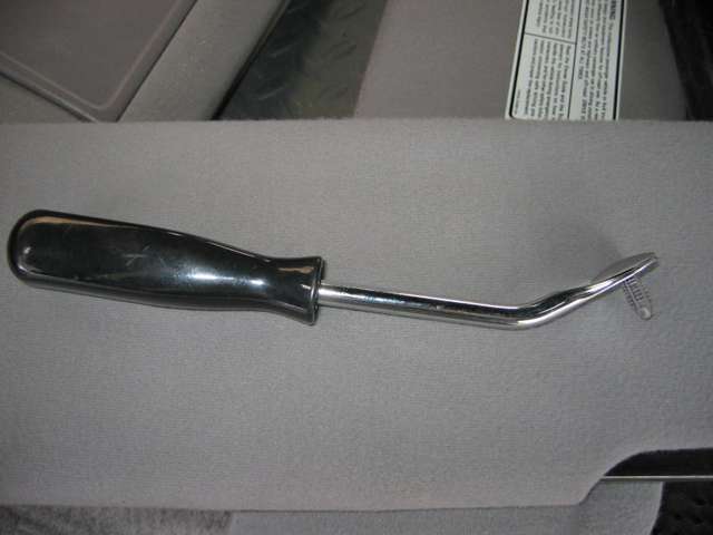

I would pick up a trim removal tool like the one pictured below (under $5 at AutoZone). The shape of the tool allows it to evenly support the push pins and remove them without breakage... I would highly recommend getting one..
