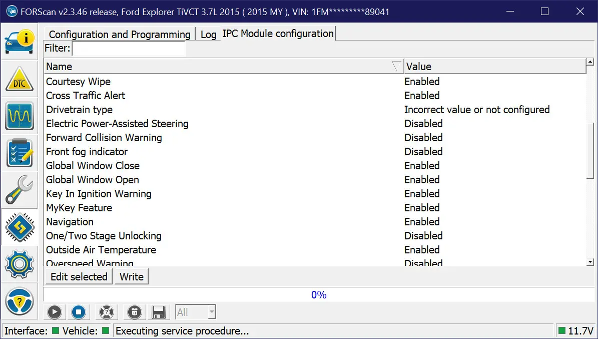

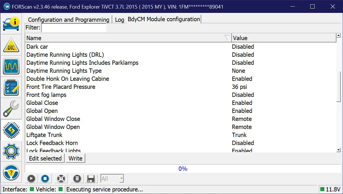

Connected to Forscan and I have the settings as in the photos. I thought it was a simple matter and didn't think the 2015 vehicle wouldn't have these features. Of course, I set all the global windows open / close to enable, but as the thread shows, it did not work.
It's not equipped for that feature even though it shows up in FORScan.
