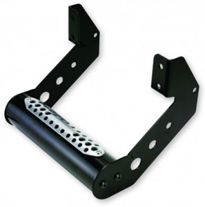

Where'd you get your step bars? I've been lookin for some like that.
Looks great :biggthump
they are the Go Rhino! 120B Universal steps
I got them on Amazon, Here is the link
http://www.amazon.com/gp/product/B000CMF7OA/ref=oh_details_o05_s00_i00
On the picture it shows a different go rhino step, But if you scroll down to the description it shows the actual picture of the product
Here is the actual product
I wanted something small and simple, These fit the bill
Oh and I plasti'dipped the chrome part lol
