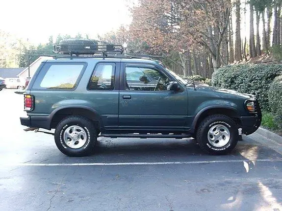

I had the same set up you describe on my ‘96 Sport. I had the Rancho adjustable shocks set to medium, Warrior shackles and Torsion twist up front. I used the “F” code springs from a 4 door. Had 31x10.5x15 Bridgestone all terrain tires. Mine rode pretty well.
Looks good. Today in fact I installed 1.5" torsion keys and had an alignment done. Much better ride up front as they keys were maxed out. I have it high enough with 31x10.50R 15 tires Bfgoodrich A/T's like yours. Rides much better. By the way, I really like your explorer. Check mine out. Now it has black wheels instead of the silver. My paint was black and chipping away on the hood so few years back decided to repaint it. Did it myself with olive drab tractor paint and an electric wagner pain gun from HomeDepot. lol! Came out like Raptor paint. Where did you get your rear brake light covers? I can't find them anywhere.

They are Smittybilt Outlanders, pretty sure I got the through 4 Wheel Parts. Unfortunately I had to sell it after my son was born. Now I have a 2004 XLT 2x4.
