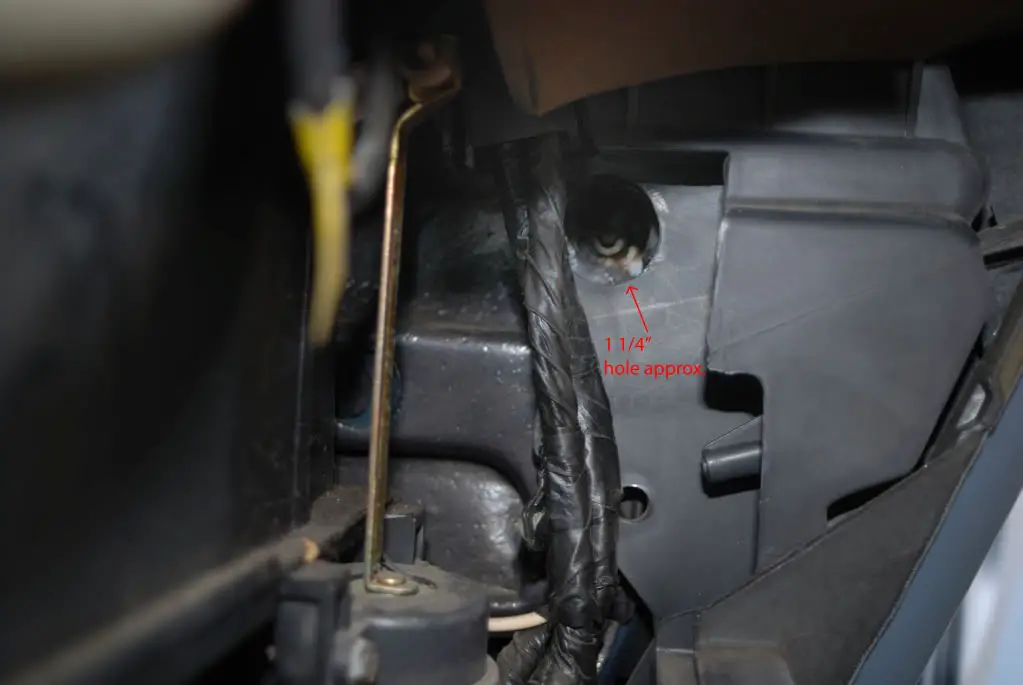

on my right side door i removed the glove box and used a 1 1/4" hole saw to drill through the plastic and insulation to get at the nut with a socket. i dropped the nut and had to get a new one. using masking tape to hold the new nut on the socket so it won't fall down the hole.

'91 explorer's right side upper door hinge access hole with glove box removed. the nut is in the shadows deep down in the hole about 2 to 3 inches. most likely you'll drop the nut removing it. use masking tape to hold the new nut to the socket so it doesn't find a new home at the bottom of the door post hole.
sorry for a crappy picture, my camera is so big it won't fit into the glove box hole without a struggle. i used a white LED flashlight to light it up 'cause my flash was not able to open in the confined space.
