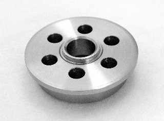

It might be the problem if the flexplate is wobbling or is slightly out of alignment. The OEM spacers are made out of powdered iron. Sonnax makes an improved version out of billet steel. I've renamed, and moved your thread to the stock 95-01 section.

Ok so I will repace the spacer, I will let you know.

there any way to get it online? do you know the web address?
Thanks!!!
http://www.transmissionpartsusa.com/Ford_flexplate_to_crank_spacer_p/400-056000cs6.htm
Hello just to let you know guys I replaced the spacer as BrooklynBay said, and now the ford is up and running.
