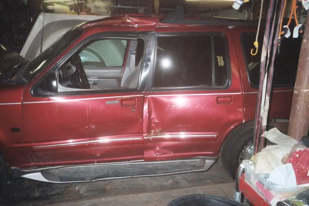

As stated previously this 97 Explorer XLT slid sideways on ice at about 15 MPH into a pole. The impact was directly between the doors. In addition as the vehicle left the pavement it leaned towards the pole at impact and caused severe damage to the Roof.

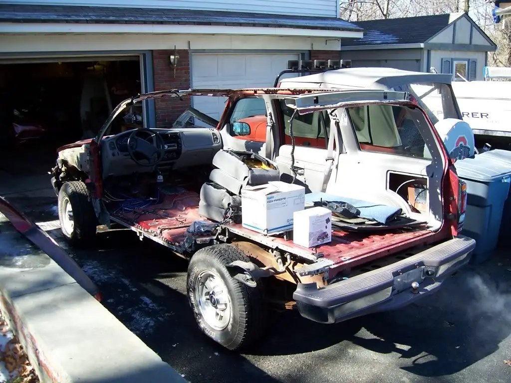

The Insurance Company Totaled the Vehicle. I had just replaced the Transmission 2 weeks earlier to the tune of about $3,000. I decided that I would take the $800 off the Insurance payout for this Vehicle and replace the Components with new Ford Parts. I drilled out all of the factory Spot Welds, and removed all the damaged Body Components. The Floor and Floor support were slightly damaged at the impact area, but I was able to dolly these back into near perfect shape.
When I found that even going through a local Body Shop the Ford Parts were about $3,000, I decided to buy a 97 XLT that was wrecked in the front from a junkyard. In a similar manner I drilled out all the Factory Welds and separated the entire Side and Roof as an Assembly. The major advantage of buying this donor vehicle is that I did not have to reassemble the Roof and Side in individual Components. In addition, the donor Vehicle had all the interior components in the same color grey as my original Vehicle, Wiring Harnesses, and etc.. A bonus is that the donor Vehicle has a Moon Roof which my original Vehicle did not have.
I decided that I did not want to remove the dashboard, so I staggered the cuts in the A-Pillar and the front of the Rocker Panel in an opposite fashion on each Body. The donor Body was then clamped and tacked on to the original Body and all dimensions checked. Once it was determined the assembled body was true, all of the Spot Weld Holes were Plug-Welded. The staggered cuts were fully welded and ground. The newly assembled Body turned out to be better than original as the rear doors and especially the Hatch lined up better than when I bought this Vehicle new!
