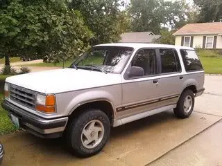

Well here is my car, the first one is of the bushing im missing, I also found out the one one the driver side is cracked in half and ill probably need to fix that.
Im not sure what that is called, not sure if its that radius arm bushing you referred to earlier.
So Here is my monster, me and a friend are going to be changing the shocks soon as they are rusted to hell, front and back. I am gonna switch out all the wiring and tubes in the engine, already changed the spark plugs, im going to put in a new airfilter before I get the KKM intake, and ive already replaced the ball joints. and new tires as stated before.
I was considering getting an exhaust system.
My ultimate goal is to get it off road ready, maybe new axles, a smaller lift like 2 inches, make sure the 4x4 is working 100%
Audio all I have is a sony xplode head unit and some speakers, no amps or anything yet.
Yep, that's the radius arm bushing. You might as well just replace them both at the same time.
