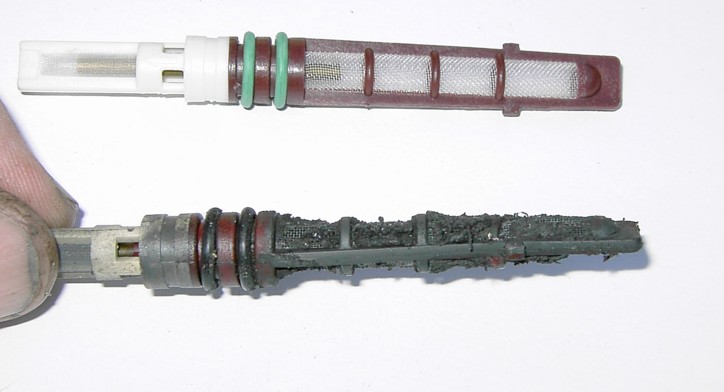

And what did the orifice tube look like? Please tell me it did not have what looked like tar or burned oil on it...If it did stop and replace the condensor as it has experienced black death and no amount of flushing with solvent will remove it...
If you have any question about black death here are a couple of pics to see what it looks like...

actually ranger I got lucky, it was somewhat clean to be honest. Even thought it was serviced recently since the orifice tube looked pretty clean considering what I read and what you just showed me so no luckily nothing like that. the compressor needed to be changed and didn't have any oil in it when I took it out so assumed that was the problem.
