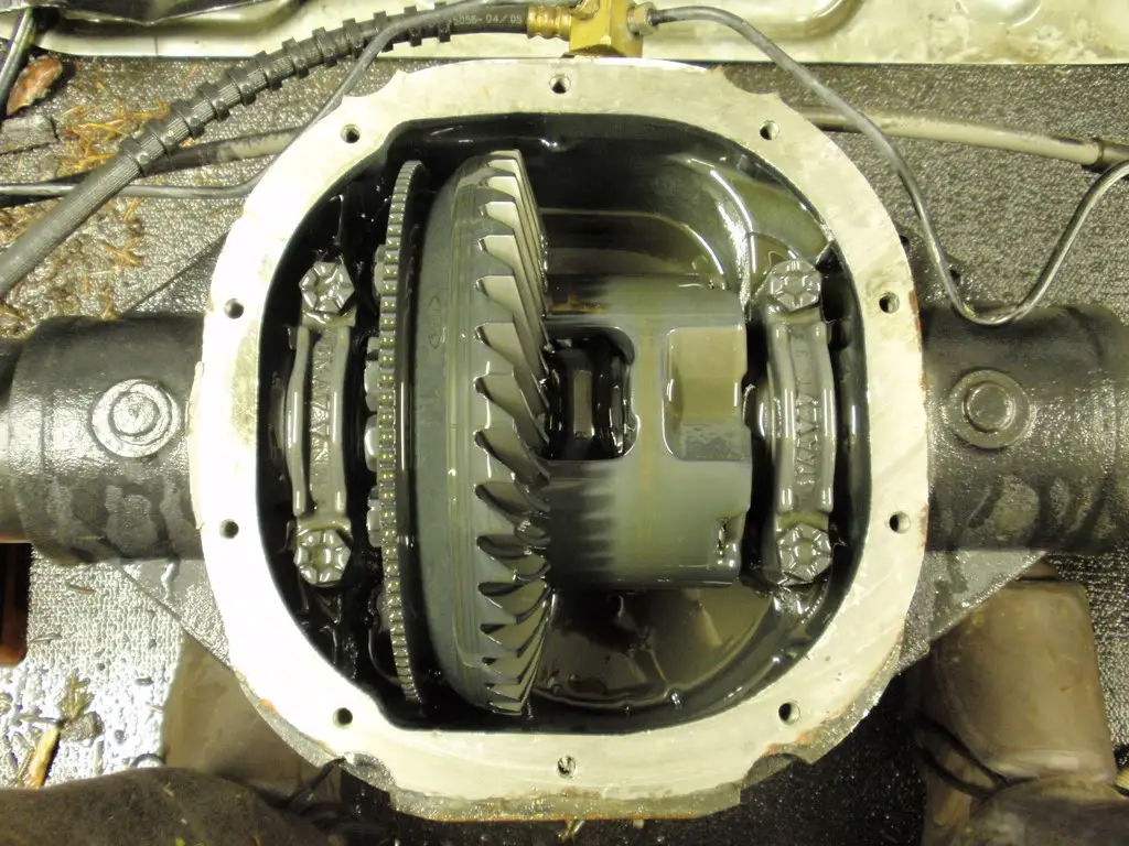

I've got a 2001 ranger w/ a 2005 Ranger Fx4 Level 2 rear end...which is exactly the same center chunk as ya'lls explorers have...31spline. The axle comes stock with the Torsen limited slip unit. BUT the thickness of the 4.88 ring gear caused the torsen center block to not be able to slide out, so i ended up putting in an open carrier so now it's open.
SO....perfect platform to install an aussie...since i'm already an open carrier. I go to install the Aussie Locker tonight and can't get the damn center pin out of the carrier in order to install the locker. The ring gear is so thick, that there's clearence issues between it and the pin. They touch approx 1/16"-1/8".

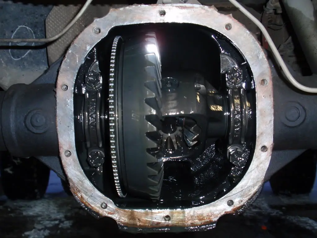

4.10 w/ torsen:
4.88 w/ open:
The no clearence for the pin to slide out...

No grinding to the ring gear has been done. it's as though it came straight out the Yukon boxes.
I am running the $35 notched crosspin in it already. Are you saying i should be running a stock like solid cross pin with the aussie??
After some looking up...i'm going to try out the die grinder to the ring gear to gain some clearence. I'm dumbfounded by exactly how the center pin was able to slide into the hole in the first place.
