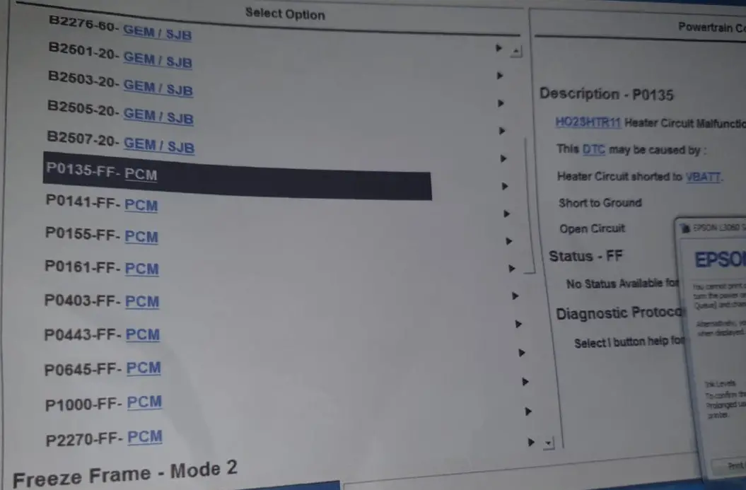

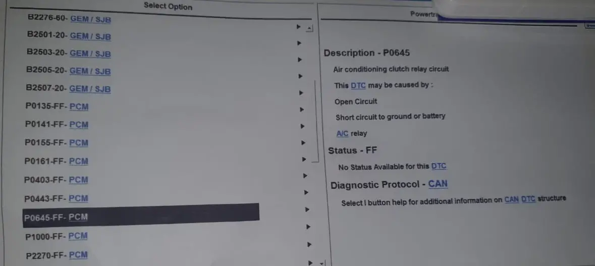

Then I went to a specialized center for a computer check, and these codes appeared:
p_18448fhdl1.jpg[/url
[url=https://top4top.io/]p_18445jipd2.jpg[/url
The technician told me there are 2 codes which is only important for this problem:
The first - P0645 is for the car computer (P.C.M), where it must be changed immediately and new programming is made. (According to the technician)
The second - P0135 is for oxygen sensors. (According to the technician)
View attachment 326727[/url
[url=https://top4top.io/]View attachment 326728[/url

My advice would be to get another opinion from another mechanic. It looks more like you have a power supply problem or a short or just a bad wiring somewhere that's generating all those codes.
