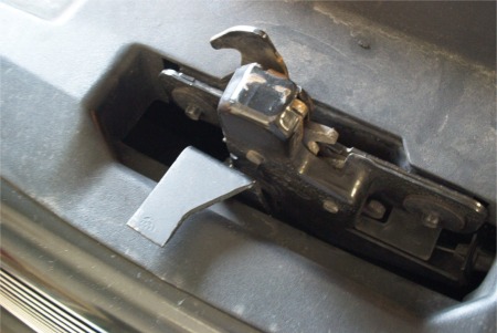

i also did a write-up of a way to make your own above the grille release mechanism like on the 99s. If you search you may be able to find it.
Here's the latch that I made in about an hour with some metal I had laying around my workshop. I tried to make it look somewhat factory.
I think I'll try that on mine, I wanna put a mesh screen behind mines
