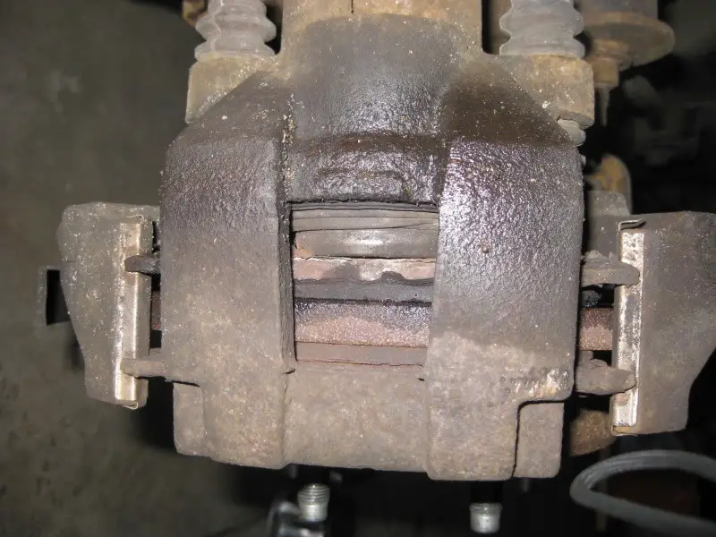

three things,, if its water soluble, its brake fluid, if its not its gear oil,,, if its brake fluid and u leak this much youd definitely be out of brakes by this time, you would see a low or empty brake reservoir,
