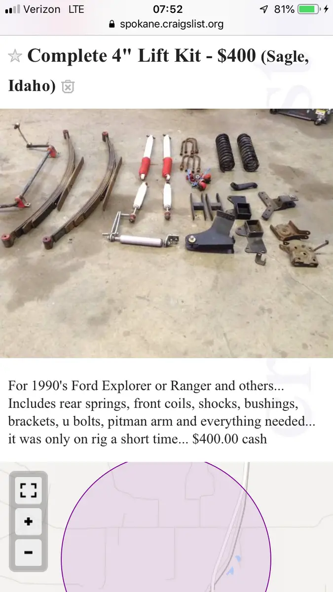

Hey guys, need some help identifying these lift parts. I’m in Oregon fighting wildfire still and have great dreams of upgrading my Jurassic explorer when I get home. Will these parts fit my second gen? I want to upgrade/replace the suspension on it and go to a larger tire size. Would this be a perfect solution? She’s a 97 XLT 4x4
Thank you so much!
I know most of the parts...starting from the left:
Front sway bar with links
2 Rear leaf packs
2 rear shocks
2 front shocks
Steering stabilizer??
Axle u bolts (replace if getting this kit)
Rear end link bushings???
Leaf spring shackles
Front coil springs
Pitman arm
Leaf anchor plates
The other 5 pieces I don't know. But my educated guess would be for the TTB.
As for your question of it fitting a Gen 2....yes they will, all but the coil springs and maybe the 5 pieces I don't know.
the parts for the rear will (leafs, shackles, shocks u bolts, leaf/shock mounts), the parts for the front will not fit a second gen. totally different
