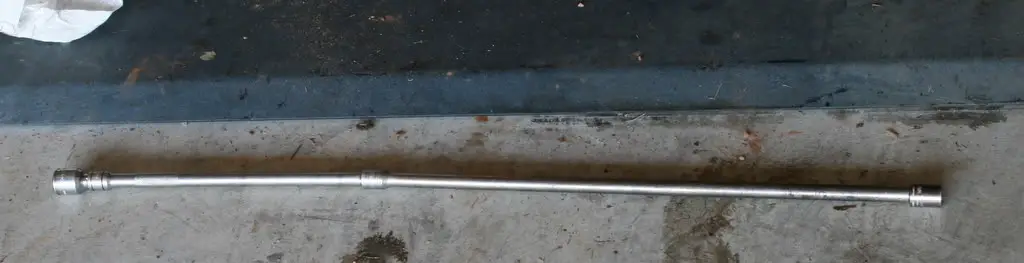

With this:
You don't need a swivel/wobble socket.
Like the pic shows. Lots of extension, over the top of the trans from behind it. Piece of cake... Now, to get the O2 sensors disconnected, takes the long arms of a man with the hands of a ten year old girl...
