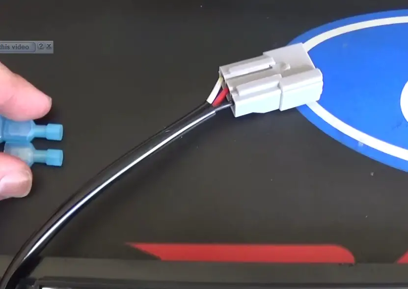

This is my disconnect here. And the connectors are different also. All the new 3rd brake lights come with this connector (see photo below).
I obviously could not find the female connector that you would attach to the wires from the truck (once you figured them out), so it could easily plug into this connector as shown below. So the recommendation is to cut off the connector below and put T-Tap style connectors on the remaining wires. But again - from there, I have no idea what wires go to which.

Since it seems that you are going to hardware it rather than find a mating connector, what I'd do is pop the release tab in the connector to pull the wires out, then do a test with a cordless tool battery. If a 18V battery, only momentarily power them so they don't overheat, or a much longer run could be done with a 12V battery. Try red positive, black negative, which I was suggesting is probably the brake light, and white positive, black negative, the cargo/bed white lights.
